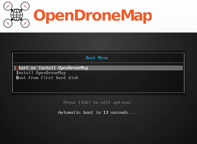

  2. Build the ISO. Run the command mentioned below
./envsetup.sh
An ISO file named opendronemap.iso will be generated at the end of this step if this step was completed successfully.
If you just want to use the stock LiveODM ISO without making changes, simply flash opendronemap.iso with your favorite program (see Flashing the ISO), plug the USB onto your computer, reboot and you’re done! If you want to customize the ISO, instead follow these additional steps:
